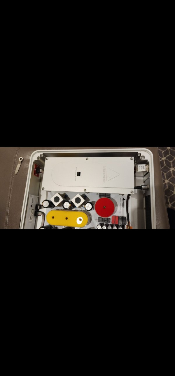

any internal photos of dac i have of power but not dac
