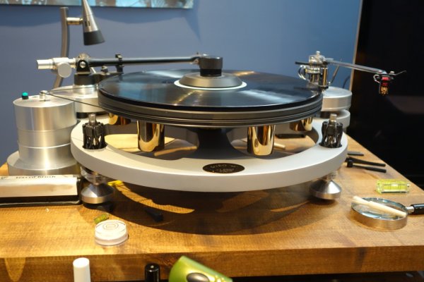

Hi all i have just made some michell gyro /orbe replacement pylons out of Delrin , they work very well , i have managed to get rid of the wow when the springs where removed and replaced with this tweak , also use 3 little rubber pads on top of the small shaft that goes into the suspension adjuster on the spilt suspension this has stopped the microphone effect off the feet ,

sort off , but they dont cost as much , you can read about them on Art of Sound cheap upgrades for michell gyro , in strokes of genius,

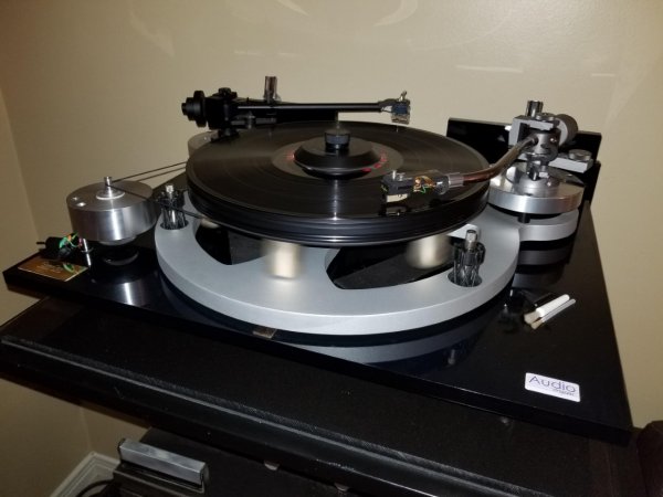

here is some one else i made them for as a hobby and not a commercial venture
That can take a while with the two cartridges that I use as one has a Shibata stylus, the other a Replicant both of which take a lot of care to align properly.
Once I had completed the suspension installation and replaced the arms and platter I did quick check just to see that all was in working order. By now it was well into the evening so I had a meal to prepare etc. so left the turntable. When I returned later I found that the suspension had “ settled” by a tiny amount ( we are probably talking seconds of arc here as the bubble level still had the bubble within the marked target area for a level setting but indicated a slight bias towards one side). I corrected this with the adjusters which , with the load of the arms and platter, were stiffer to turn than without it ( no surprise). I had a couple of similar tiny adjustments to make later but now all is completely stable. Oh, and the cutout in the motor housing now correctly aligns with the chassis position.
The result is quite something. Compared ( from memory) to the old spring suspension the overall resulting sound is far more neutral. That is the natural timbre of instruments is better revealed and the difference between recordings from different sessions or record labels is more marked. Bass is not extended further( it was always good) but has gained pitch and detail. Background noise is zero except for any pressing or tape modulation noise etc. on the disc. Although the turntable has gained neutrality this is in no way sterile and the ability of the Orbe to communicate is enhanced not diminished. Likewise the wide and deep three dimensional soundstage is improved. In particular regarding the bass end of things, the sound no longer tends to clump around the speaker position. These are all details, though, compared to what I find is the main benefit. The overall stability of the sound reveals entire passages of music that had previously passed unnoticed. That is, what may have been a generalised, pleasant, orchestral wash of sound now attains form and structure giving it real meaning. This is a major achievement.
I am absolutely knocked out with it. The above relates to the situation so far with the stereo arm/cartridge. Now to fettle the mono arm and cartridge.
One thing that I forgot to mention ( should you wish to use my comments as a quote anytime) is the great reduction in audible wow that the lack of lateral movement of the chassis that the new suspension provides. In fact I have been trying discs that could bother me greatly due to being slightly off centre with the old spring suspension exaggerating the effect. Now those same discs are easier to listen to with some of them now no longer providing audible wow ( it is no doubt still there for a meter to find but I listen with ears). regards
