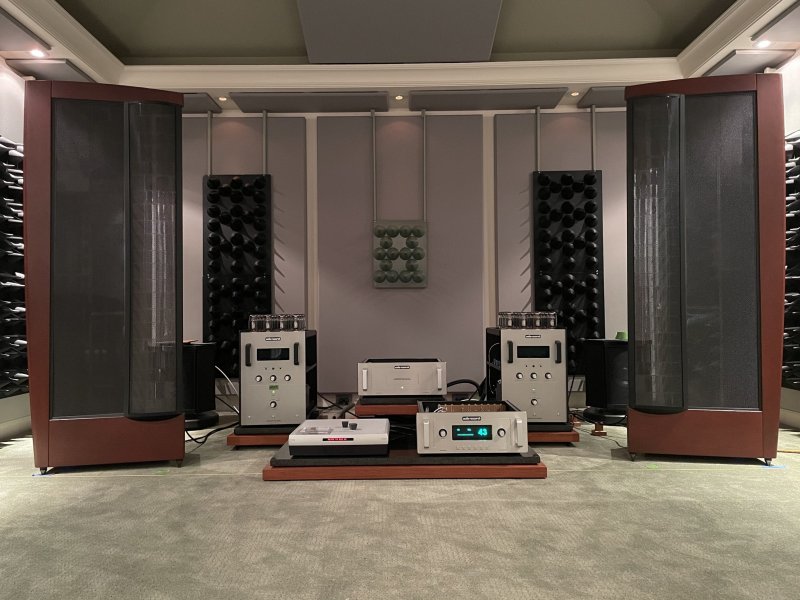

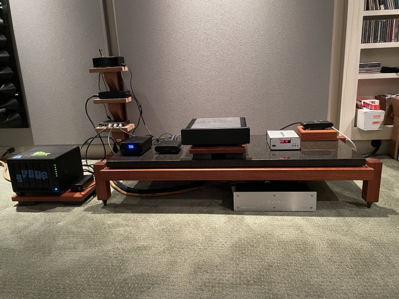

I decided to eliminate the 8M interconnects between the pre and amps and move the pre and DAC to the front of the room. I replaced the long interconnects with 10M of fiber between the PlayBack Designs Stream IF and the MPS-5. I did DIY OCC star quad cables that are under 2M.
The image and detail is much better than I would have expected.
The rest of the front end is where it use to be on a single level.
I still need to build an 8M power cable to get the filtered power from the rest of the front end to it new position at the front of the room.
