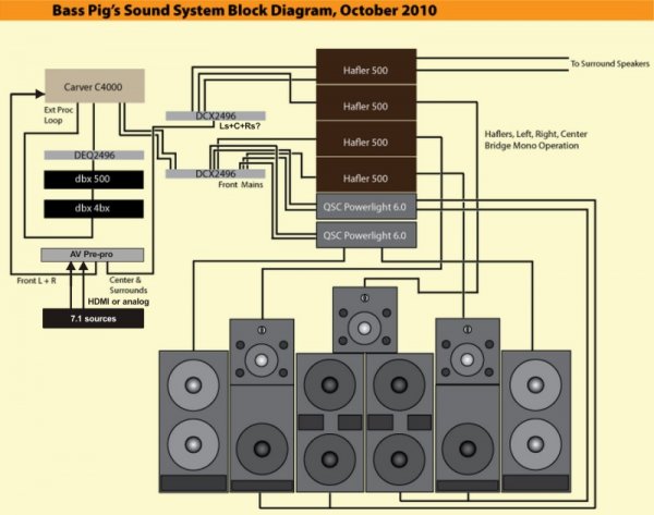

Is the attached your current setup? If so, Why not feed all of your 7.1 sources like the Oppo into an AV processor like the Marantz AV7005, decode and bass manage there? It will handle 5 HDMI sources and one 7.1 analog bypass.
BDP-83, or 83SE?
I don't want to add yet another expensive device (also electricity consumption) to the rack. I am in the mode of reducing my quantity of gear for fewer things in the signal path, lower power consumption and heat output. Some of these processors cost more than the Zektor. I still need analog, as I run all analog (except the ext proc loop) from preamp to power amps.
Really needed to switch players the other night.. had a BD that the Oppo could not play and had to use my Sony player, which could play it. Only problem was I was looking at over an hour's work to pull both racks away from the wall, get behind there and switch ten cables over from the Oppo to the Sony.. :(

Analog outs from my Oppo 95 direct to my amplifiers sound better than HDMI in to the Marantz 7005 that I had. Eventually, there will be a prepro under $3K that will sound that good but until then, I'd like to find a relatively inexpensive work around.
HDMI 1.3 devices are quite reasonable in the used market now.
LoL! Sorry, that just struck me as hilarious. The power consumption in your rack is over there in the amp stack, my friend.
You mean the Zektor that you cannot find? :rolleyes:
The Marantz of course has analog outputs. It even has one analog bypass input in case one of your sources for some reason has no HDMI output, like an older SACD player.
I guess you didn't need a solution bad enough, though.
Believe me, I've spent over 65 hours researching alternatives this week--it's just about ALL I've done for the past 5 days!
You say how hard it is to crack this nut yet easy solutions are right in front of you. And if after a few months you score the Zektor, the AVP goes back on e-Bay. In the meantime, you're up and running. :confused:
