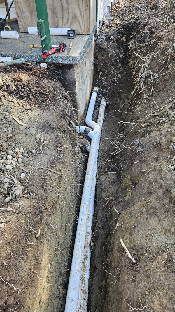

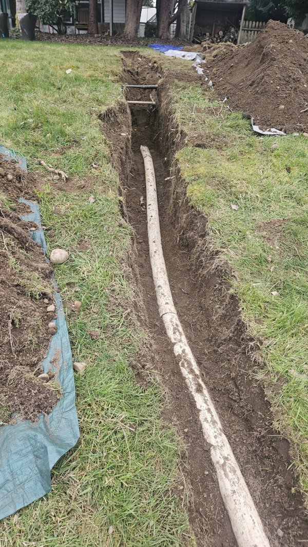

Before I could even begin working on the interior of my house, I had to deal with floods of water coming into the crawl space in two sections. I had to take down two large trees to access the piprs on the front of the house. They were sitting right on top of the pipes. Both required about thirty to forty feet of trenching four plus feet down. We had a pretty massive rain in the last 2 days, and I'm happy to say. The crawl space is now staying dry .
Tomorrow I continue with the crawl space encapsulation, I began a month ago. That was when I discovered how much water was really getting under there.
It turns out the original contractor building the house decided to go. Cheap and join the downspouts. To the footing, drain has one pipe to exit. Of course, he screwed it all up so the downspouts were really dumping all their water into the footing drain, which then became a lake under the house. I had to separate the system on two ends of the house.

Does the home have a French Drain?
It had a footing drain as well as downspout drain. The jerrkhole builder tied the 2 together so he only had to exit one pipe. Of course e screwed it all up. The downspouts were dumping their water into the footing drain system and flooding the gravel bed and footer around the whole house. There was also a separated downspout pipe on the opposite end of the house that was dumping its water into the footer.
Reactions: John T
Yep, too much volume. When I built my house I was able to divert the downspouts. The ease of new construction vs fixing others mistakes. I put the French Drain in, I bet I did at least 2' deep of gravel over the black pipe after coating all the blocks with black tar sealant. I didn't have a tractor with a bucket at the time so it was all shovel/wheel barrel work...Are you doing total encapsulation? Dehumidifier and everything? Done right that's a great application. I thought about having all the insulation pulled out and shoot foam between the joists. I looked into that after I had to fill the cavity from a former root cellar. We pumped 10 yards! I thew everything you could imaging in that hole, blocks, old steel wine barrel racks to stretch the concrete. The guy with the pump said you don't need to do all that. As it turned out I did. If I didn't I would have come up short....
