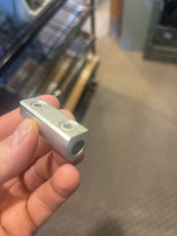

I'm going to go with the Legato (for amp, preamp, and analog) as well Rex. In the end, I ran 8 g to10 g on a Eaton silver plated copper ground bus. The NQ panel was too expensive as we needed money to remodel our master bath in the rebuild. I haven't found a way to join the 8 to 10g wire. I just got all the wire installed yesterday. No twist, too much work and time. I still have to work on the panel itself before wiring that up. Perhaps not the most ideal, but should be a nice upgrade for me in the end. So Thanks Rex and this forum for well timed advice!
It will be excellent chris. And i'm glad you didn't twist romax. That's not good for it and doesn't really do anything.

Thanks Rex! Here are two options I found for connecting the 8 to 10.

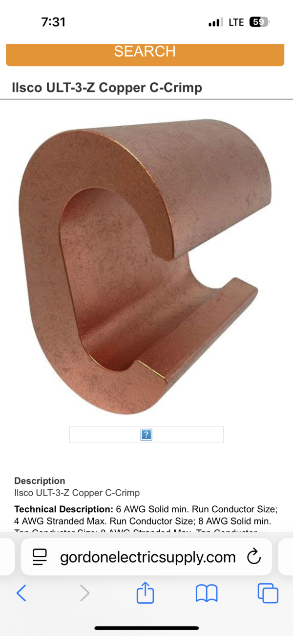

If I were to crimp, I’d rather use these

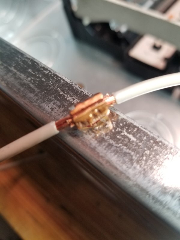

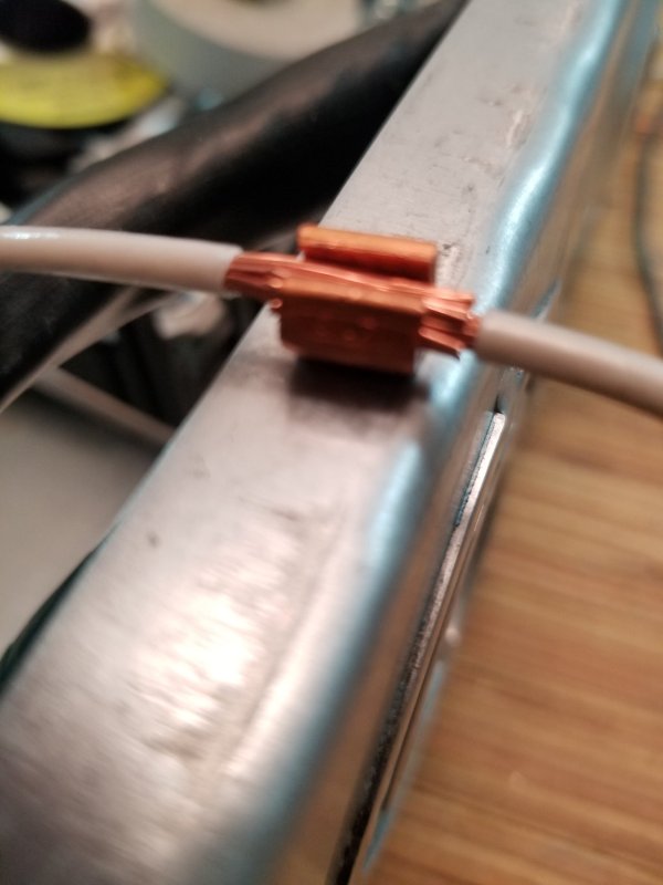

Basic idea how I tag a wire on. This is an excellent way to stack 10s on a branch fed from a AFCI. AFCI will only take one #10. You keave a long end that goes into the breaker and start C clamping wires to the main trunk. Picture is a simple splice. I like the conductors touching. I am not as much a fan of a end to end barrel.
