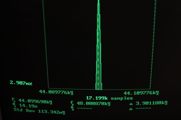

Here is our approach on jitter.
We use many techniques regarding lowering and canceling jitter,passive and active ways.
Bouncing digital signals, overshoots, low rise times etc greatly increase jitter. We solve this by using special digital driving circuits,tuned buffers and carefully tuned digital line terminations for all our digital signals,so we elliminate the creation of jitter through the ways described above.
Crosstalk between digital lines, ground noise and power supply noise and crosstalk is a major source of random and deterministic jitter. We use extensive LC filtering(using high loss RF chokes and high speed capacitors) to all ICs ,power rails and logic circuits,(up to 70 separate filters) to solve this problem.
Jitter originated in USB and Spdif/Toslink sources is canceled right at the conversion-enable line, or the ”refresh” signal of the converters.
Having an IC that is has no complex data handling logic and no multi stage data logic, the highly precisely timed signal, resolves in a extremely accurate jitter free conversion.
This is not possible with any other converter,as there will be always internal logic and data handling, vastly deteriorating jitter performance, even if the clock input is close to perfect.
The Super clock is also used upstream, for reclocking the XMOS asynchronous usb controller, as well as the SPDIF receiver.
Our recklocking techniques are glitch free and does not require for additional clock inputs-outputs for the rest of the audio chain,such as the transport.
Most important aspect of the techniques we use,it that there is absolutely no further digital data handling AFTER the recklocking of the word sync,or "refresh signal" so no jitter can be created further downstream,
Jitter is very much audible, and I felt that the dichognomy must end. That is why the digital input re-clocking circuits are bypass able on the fly, so every audiophile can make a AB comparison ,on the fly, with the turn of a knob.

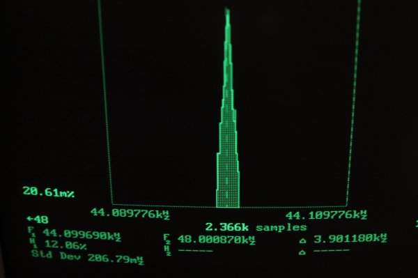

Below are some measurements on the modulation domain(i find jitter measurement on analog domain useless),jitter distribution of a typical "high end" transport, jitter after first reclocking ,and after second reclocking .
