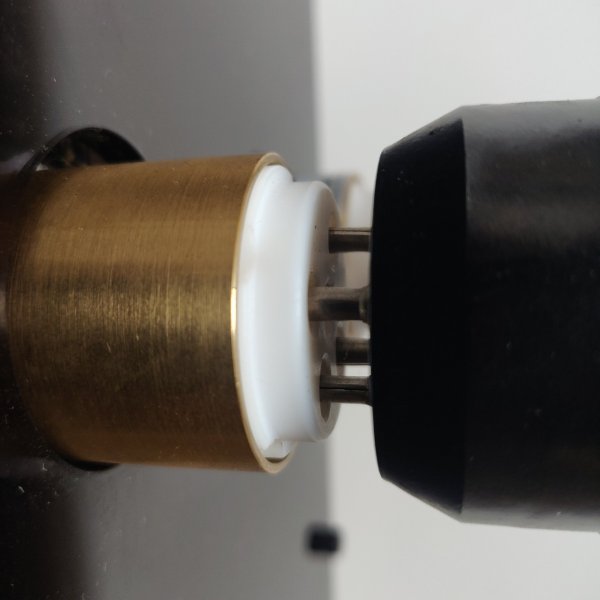

It is very easy to do. I just did it.
Raise the tube in the adaptor like the picture below.
Set meter as below. Black lead in Com, red in 10A or whatever you meter has that is higher than 2A. Set to DC.
From https://www.radiomuseum.org/tubes/tube_px25.html you know the f (filament) pins are opposite each other. So there are only two possible pairs to try. Be careful to touch only two opposing pins. The one with the current reading anywhere near 2A is the one you want. The pair that read virtually nothing isn't.
I just got 1.75 amps reading mine. A little short but an honest reading which is important. It floats around that figure a bit.
Shame I couldn't hold the probes and take a pic, sorry.
I am NOT using a Pac. My DAC is no longer a Lampi, really.
I just did the same with an Osram PX25 and got 1.8A on average.
