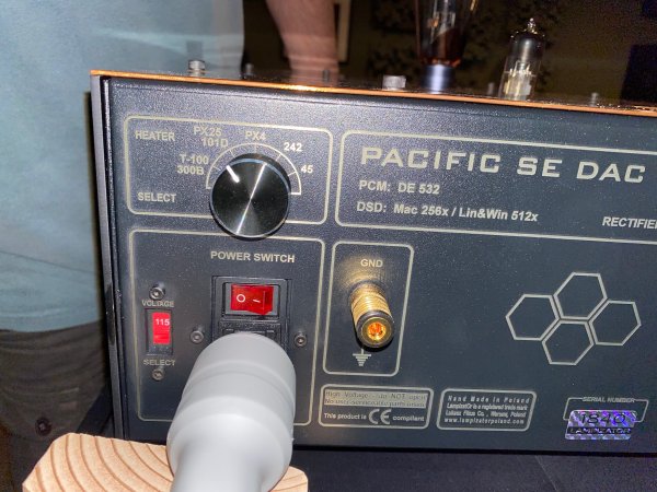

Pac has no PX25 setting, so use 101d setting for PX25, AD1n & RD too. AD1 should also use PX4 setting.
My PAC has a PX25 setting.
