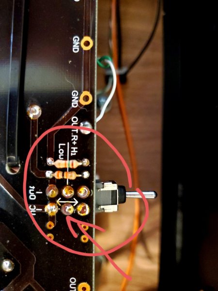

Assuming you won’t go with the VC option ( I am actually considering going to the VC option if one day a MK2 or any kind of other improvements are being offered) you have a low/high gain switch totally independent of the tubes you are using. In my case the switch is located on the bottom of the unit ( as the provided Stacore feet are pretty high , it s easily accessible ).
Originally I ordered the RKPX25 tubes and the low gain switch with those tubes is providing a 2V output whereas the high gain is providing 6V output with those tubes again.
Then I bought a pair of KR242 and those tubes have more gain so I believe the 2v/6v range is no longer exactly respected. And with those specific tubes with the high gain switch on ( no issue at all with the PX25) I noticed some digital clipping issues with some recordings but also depending on your downstream preamp ( with a passive bespoke pre absolutely no issues at all) .
( I also did a test by using the Roon digital volume control. I had to put -3db to avoid the clipping issues)
So if I were you, I would ask to “calibrate” the high gain switch with the KR242 tubes in mind so you should be safe as those tubes are the most powerful ones I am aware of. And would you go with another tubes it will work smoothly even with the high switch on.

David all non VC units have them and they are inside at the back of the unit at the edge of the board where the tubes are. There are two switches.
You can easily check also the output V via tech sheet as the values for the high/low gain V are written on the bottom of the first page.
And yeah its meant to be used ;)
I popped the cover off after Fred told me this. It was shipped in the high gain position and that's where it will stay. I tried the low gain but I had to push my preamp too much so I just put it back at high.
Reactions: christoph and Golum

I took the lid off my Pac tonight to look for my gain switch is unfortunately not on the outside. It caused some issues such as one channel having no sound. Luckily I got it back but I wouldn't recommend fiddling either it too often. I have mine in high gain for PX25, RD27 and 300B.
