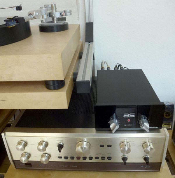

One should perhaps also mention that the Swissonor Historic shows its strengths especially with shellac records. (Acoustics and Blumlein) unfolds.
Vinyl monos from RCA, for example, it can not operate because the "bass boost" only reaches up to 500 HZ.
The AS Monophonic -True Mono-, also a pure single channel amplifier, can do that. Even steplessly. Here in the picture it is set to DECCA equalization.
The Miayima ETR mono system btw. is quite excellent. Some guys of our AS Community love this thiswonderful cart.
