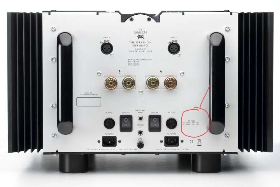

Older models of Gryphon had two fuseholders for 110v and 220v. Simply insert a fuse of the appropriate value and remove the others. I'm not up to date on whether they've changed that.
P.S
American fuses are longer than European standards, so a different cable outlet on the fuse holder is contacted
Zoom in the picView attachment 142776
P.S
P.S

I was not aware of different lengths of EU vs. American fuses?
On the the printing of the back of the amp in your pic at 230 v you draw 1/2 the current thus the fuse capacity is halved for EU voltages- the fuse length is the same in all equipment I've seen - when you change taps or configuration for 120---> 230v or 230---> 120v you change the fuse capacity not one with a different length-- at least in every piece of equipment I've seen.
I must admit I am not familiar with this concept of different lengths for EU vs American fuses generally home electronics use 5x 20mm or 6.3 x 32mm or ( 1/4 x 1 1/14 in our lingo) they are standard sizes.
Reactions: Holmz
