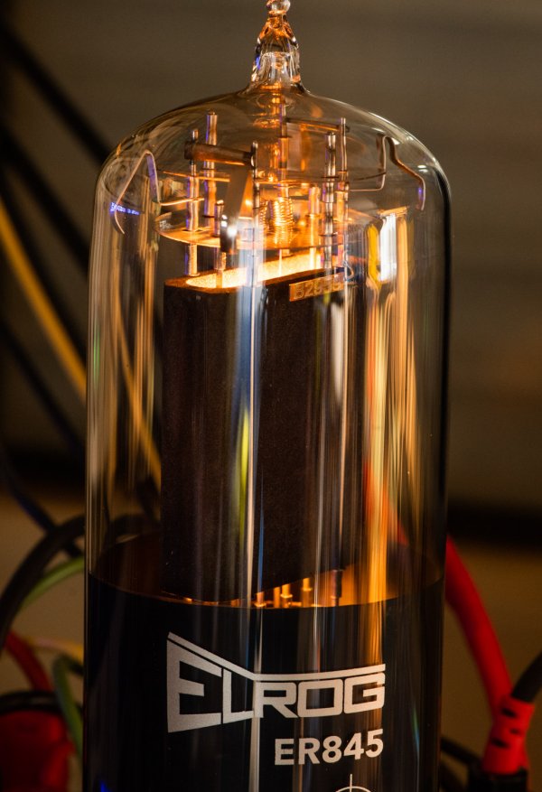

Hi Kingrex,
Although the information is a bit scarce I am trying to deduct the operating points you are using.
I assume the numbers in the first column are the cathode resistor which biases the tube.
If I then pick the 1200 case, That means 124V across that resistor which results in 103mA plate current
Since you are stating 87 W, I assume the Vp value given is from Anode to ground and not from anode to cathode. So the actual voltage across the tube is 967-124 = 843V. This would match the dissipation number given
103mA * 843V = 87W.
Have these measurements been done with the Elrog tubes? Or are these some measurements done with other tubes while the amp was at your technician? Different tubes will settle at different bias points so if you want to determine how you are running the tubes, you need to measure with the actual tubes in the amp.
I recreated a similar op point in a test set up see photos attached. 103mA and 860V . No color whatsoever visible on the plate, see photos.
I have to push the tubes to beyond 100W to get some cherry red on the plates, still barely visible but in a dark room you will see it. I will also show a photo.
And just for the heck of it I pushed the tube to 140W which then shows a clearly visible red spot on the plate. Of course this is not recommended but the tube ran like that with no issues.
As I wrote earlier the amount of red at the highest plate dissipation can vary a bit from tube sample to tube sample and especially depends on how the tube is installed. If there are no holes on the chassis around the tube socket which allows some airflow for convection, the tube will get hotter. Also in my test set up the tube is unobstructed by any chassis walls, chassis walls near the tube reflect heat back to it. Also when the amp is on for several hours everything will heat up and while at turn on no red might be visible it can start to show after some time.
So I would check your actual op point. If the Vp you listed is from plate to cathode rather than from plate to ground that means the tube runs at 103mA * 967V which is 100W. That would explain why you start to see some cherry red. Also when you are at it please check the filament voltage. The filament contributes a whopping 32W to the plate dissipation and any over voltage there is also not good. Also mains voltages can easily vary by 5% in some places even 10%. So if the measurements have been done at your technician, verify them at your home with your mains voltage
As I stated above a very slight barely visible cherry red is tolerable. But as a tube manufacturer and amplifier designer I must say this is not healthy and not a good operating point. It does give you maybe 15W output power probably less and if you push the amp loud it will distort earlier. When the amp starts to clip this can shift the operating point significantly from the no signal condition and cause higher plate dissipation. This is also an op point which will give you more even order distortion than other more sane conditions. This might subjectively sound more lively. Also note how the power supply voltage in your amp sags from 1011V to 967V between the 87W and 61W condition.That is a 44V drop for a mere increase of less than 30mA. Also does not look heathy and when you push your amp hard this voltage will start to fluctuate with the signal.
I hope this helps to shed some light on the situation.
Best regards
Thomas

Excellent info. Last night I put mine back in. They were about where your image is at 105 watt. My amps are very open with good airflow around and under the tube. They are 3 iteration old so the transformer may be better now reducing that voltage sag. But I don't think so. Not unless you pay out the nose for a wider band silver transformer.
My numbers are based upon the Psvane ACME tube.
My main voltage is pretty rock solid here. All around the city my fluke reads between 120.5 and 123. My house is generally 121 to 122.7. Its 121.8 and 122.7 today.
Since I have the 1.2k in, I will shoot for the 1.3 and see if that clears the glow.
I don't know if my tech is competent enough to mess with the filament voltage. That may start a cascade of other issues. He is excellent with guitar amps. I am one of the only people dragging hifi into his shop.
I am considering switching to 240 volt. But it won't do much as my transformers are not center tapped. The back end result will be the same voltage.
Are you saying the transformer has been changed since those measurements have been done or why do you think the voltage sag is less now? If it is less that would mean you might have higher voltages than you listed above? Silver transformers have nothing to do with this
Since you are running the tubes seemingly right at the dissipation limit or even a bit above, I strongly suggest to get voltages checked to make sure you are in safe territory. Also vital to check with the actual tubes you are using.
Having the filament voltage as close to the nominal 10V as possible contributes more to long tube life than the plate dissipation. So it is worthwhile to check this. I have seen amps running 845 at 11V. Also undervoltage on the filaments is not advisable.
Hope this clears some confusion. I regard our tubes as very sturdy and they can handle some abuse. Also we designed them to be as close to the original as possible. When you check the bias point listed in the measurement protocol and compare for example with a later vintage GE 845 data sheet which also allows 100W you will see that they are nicely spot on.
Best reagrds
Thomas
Reactions: Golum
No teansformer change in my amps. The manufacturer has gone through 3 interactions since these were made.
I will have the filament voltage checked when the rebias happens.
Thanks.

Anyway the bottom line is that I love the sound of the Acme 845, they are quite a step up in performance from the WE variant which was already very good and I continue to run them with the glowing mesh. I will let you know in time if I have a premature failure, to date I have about 50 hours on them and they just keep getting better, the bass now has come up to a solid deep sound where it was a little lean to begin and the ability to produce acoustic guitar with both body and detail with a lovely harmonic structure can be sublime at times , in comparison the WE variant sounds a bit thick and slow in comparison.
I have my fingers crossed that they do not fail, I am not sure what I would use it because is so hard to go backwards in sound once you have heard something better ! From the reviews of the Lin Lai and Elrog to date I am not sure that they are any better than the Acme or the WE for that matter.
Below is a pic of one of my glowing valves...
