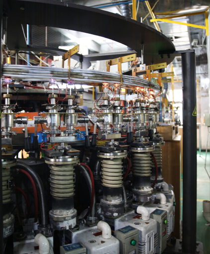

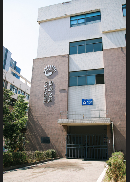

PSVANE is also known as Changsha Hengyang Electronics Factory. PSVANE is our own and exclusive brand. Alongside JJ, we are one of the two largest vacuum tube manufacturers in the world. Last year, our annual output reached 1.6 million tubes, making us one of the only two companies globally that produce a full range of vacuum tubes. Our products are used in audio equipment, musical instruments, and even medical devices.
In addition to our own brand, we also handle OEM production for many domestic and international brands (though I’m unable to disclose specific names due to confidentiality agreements). Altogether, our company has a team of over 300 employees, including those working on the production line.
