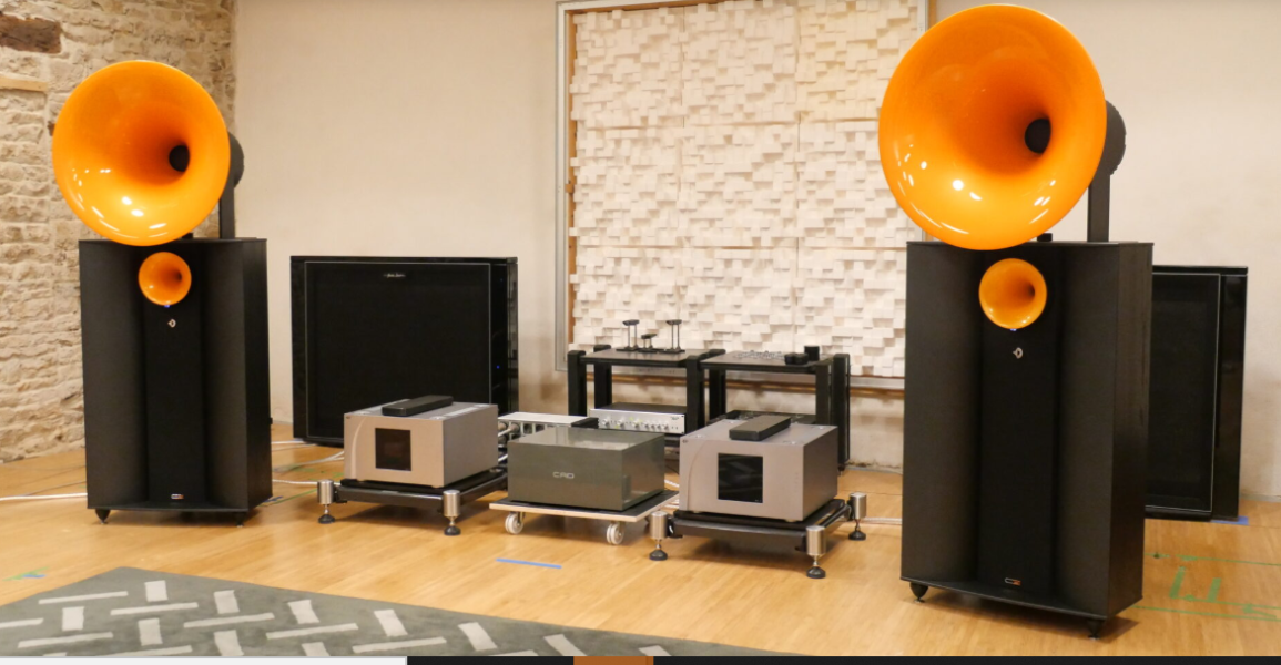

Let me address the against the wall idea. You can see a picture of Patrick's system a few posts earlier. He is mating the Pure Low with the Qual ESL. In that picture he does not have them too far from the wall. From the picture I would guess 15". In Roy's latest review of the Avantgarde Mezzo he has a photo showing the Pure Low in the background. From this picture they look like they are less than a foot from the wall. Both Patrick and Roy are pretty picky about their sound. So this suggests to me that the Pure Low can set these up pretty close to the wall. I have not personally tried it but it should be possible. Of course, if you are saying you need them flush to the wall with zero latitude for movement then I would say DSP is very likely needed.
Here is what Roy said in the HiFi+ review a few years ago. "That is where the PureLow LO breaks all the rules. Okay, so a frontal aspect that’s all of four-foot square definitely qualifies as big, but then it’s only four inches deep and you can use it a matter of six inches from the wall. More importantly, this is by far the easiest subwoofer I’ve ever had to position and adjust."
