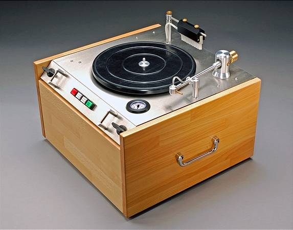

Loricraft
Are these the two best machines?
Hey Greg,
I'd like to know what the difference is between the Monks and the Loricraft. I'd also like to get ahold of one to try against the VPI.
Myles
