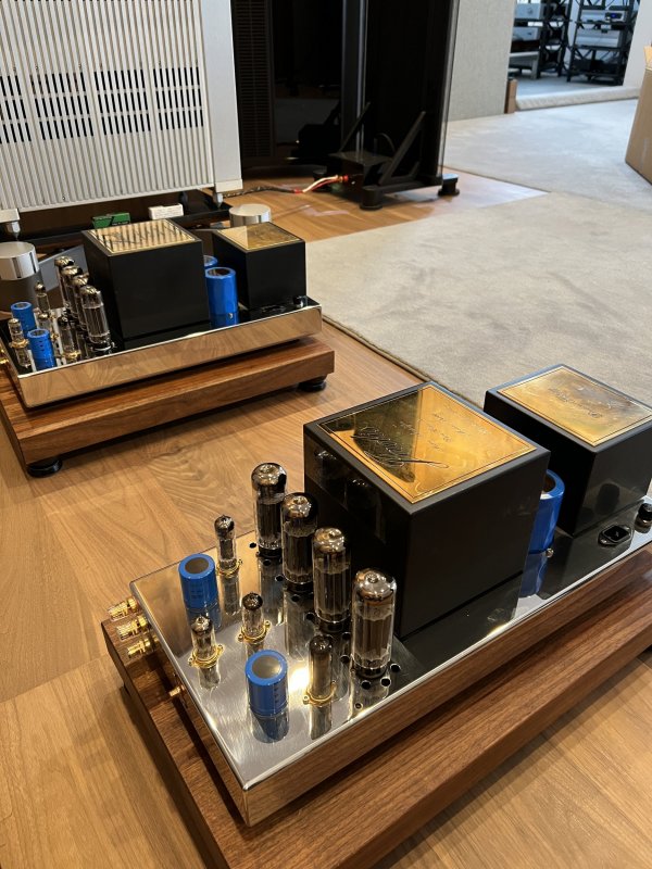

The Sorbothane-footed (which everybody loathed) walnut blocks are back in service under the JA100s!
  • Love
Reactions: Johan K

I am picking up the Jadis JA100s today!
I am going to try using the single-ended VTL outputs (run side-by-side with the balanced cables going to the woofer towers using the VTL balanced outputs at the same time).
The amps are arriving with Electro Harmonix KT90 tubes. I am working on finding NOS Siemens EL34s. NOS Mullard EL34s might be "too much of a good thing" with Jadis.
I am not sure which transformer taps the JA100s presently are set for.
