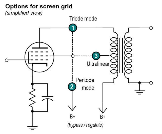

Class AB in jadis too the screen grid of the pentodes is not placed on the anode for triode operation. In triode mode only 30-40% output power.class Ac50b96_bb56d324422d48e796243c0c27a4a1b9~mv2.jpg

I am not sure what you are saying. Jadis JA200 and below is Class A. That's why 10 KT88s yield only 160 watts. Ten EL34s probably yield 100 watts.

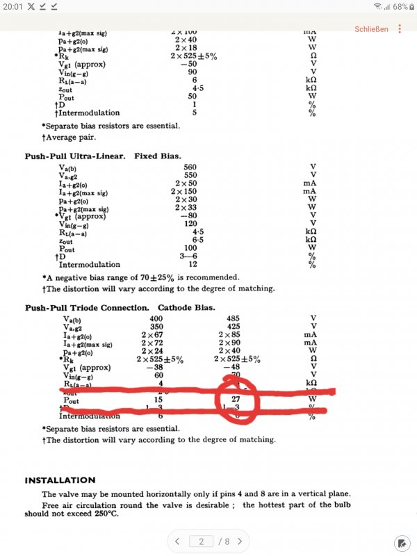

Look at the datasheet this maximum power out one pair kt 88 tubes in pushpull triode.
If you operate the tubes like this, the tubes won't even last half a year. I think if it can manage ja 200 ~ 120 watts class A at 8 ohms permanently, that's great. But I think less so. Maybe I'm totally wrong, then ignore me.
P.S. with El34 max 90watt works
5 pair ×27 watt.View attachment 117187

More than 90 watts class A with 10 El 34 per channel is not possible. The tubes then run hot with too much current.
Exsample Maximum load capacity EL34 = 25 watts
Jadis runs at 465volt (anode b +) x maximum idle current 45mA = 21 watt
I wouldn't increase the current any further, otherwise the tubes would be used up too quickly. That is a value that I use myself for my EL 34 power amplifier. A pair of EL 34 Power in push-pull triode results in approx. 16-17 watts of output power at the specified idle current. Jadis 200 has 5 pairs ~ 90 watts
