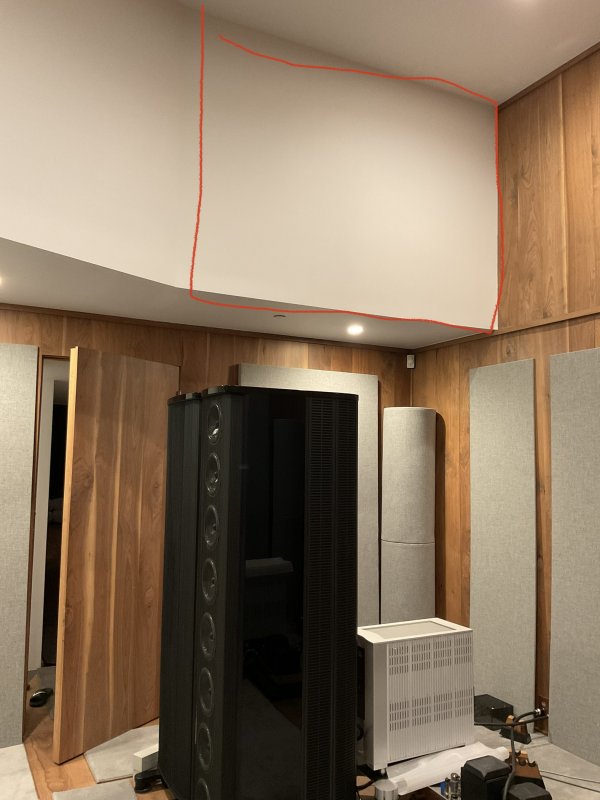

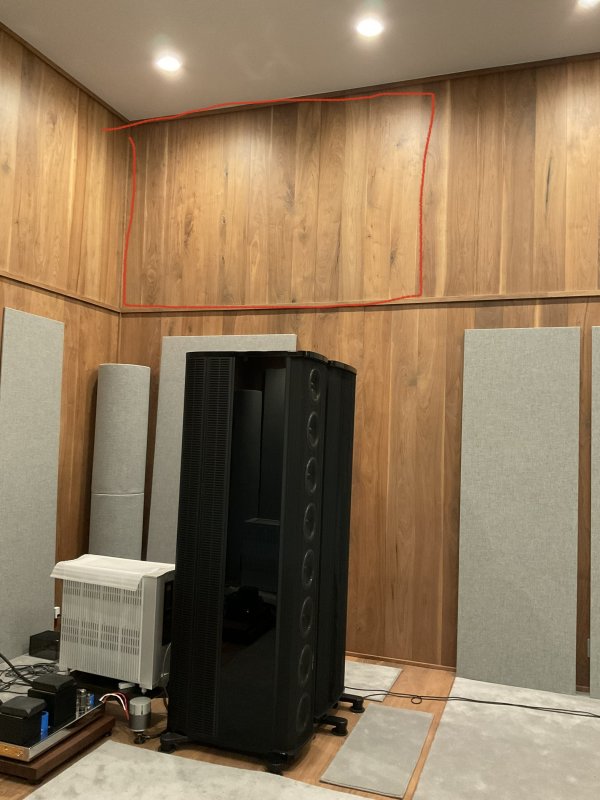

J.R. recommended 2" thick acoustic absorption panels on the parallel left side and right side upper corners of the walls. I am going to implement his recommendation.
