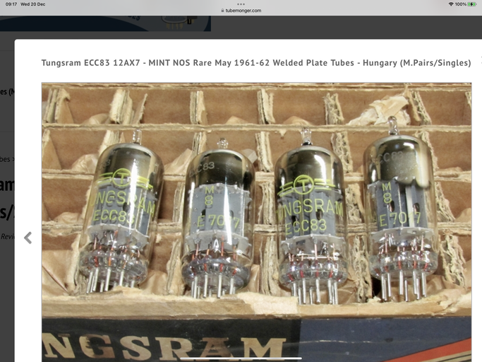

I was surprised that the Mullards were too "plump and rich" for me! Far worse than that, they gave the music a bit of Valium.
I concur with the neutrality of Telefunken’s as an excellent candidate for a phono stage … however which Mullards are you and @Kcin referring to ? I certainly would not consider Mullard M8137 / CV4004 to be as you describe .
Ok … One last try at neutrality with a soupçon of desirable harmonics :
IMG_9997.jpegThe Red Print 1960’s being high grade examples .
