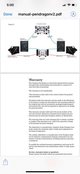

I have now calculated that the interconnect length between my line stage in the equipment room and the farther Pendragon bass tower in the listening room will be fifty-five (55) feet (allowing about four feet for measurement error and moving the bass towers around).
XLR or single ended? You should use a very low capacitance cable, otherwise the load on the preamplfier will be significant. What will be the length between preamplfier and amplifier?
The Gryphon bass towers have a bridge to connect to the amplifiers, so the line stage to bass tower is the only long length.
I would prefer single-ended connections in general but my first thought is that that length requires balanced interconnects (the Io output and Gryphon input and outputs are true balanced, I believe).
But Mr. Fang says his AM Audio 833S amplifiers sound better with the single-ended input.
I agree, microstrip! I believe the MasterBuilt Ultra interconnect is very low capacitance.

I had no understood that the speakers include an active crossover for the middle/treble.
Using a stereo amplifier creates a very large ground loop - I would go XLR in this case. Probably the best choice to go RCA is using monoblocks and properly floating the grounds.
Actually, the crossover at the base of the ribbon/AMT panel is passive.
Now that I think I have dropped the Alieno from most serious consideration I’m not considering any stereo amplifier.
