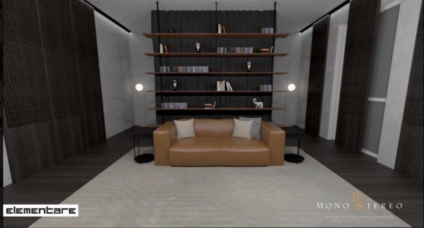

This is Matej’s new room:
Tinka asked me hopefully if our listening room is going to look like that. I replied “ah, no.”
