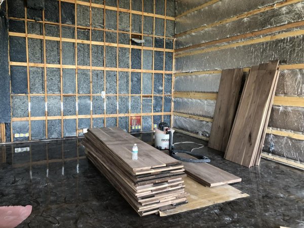

The 3/4” solid walnut hardwood planks pressure-glued together have arrived.
:eek:
Lol
The sheets of walnut are made by pressure-gluing together three boards each of which is about 8' wide. (I was not previously aware of this pressure-glue process, but people I asked say the glue joint winds up being stronger than the wood itself. This is how large hardwood dining room tables are made.)
To answer your question the wood sections will be oriented vertically and be either screwed or nailed and also glued to the wood furring strips. THe wood will cover the left side wall, the right side wall and the front wall.
The wood will be sealed with a clear oil stain, as urethane can result in an acoustically reflective finish.
They will be putting a horizontal walnut strip or molding over the joints/seams at the 9' level and then another one at the ceiling level. I am expecting that such protrusions from the walls at those heights will not have any sonic effect.

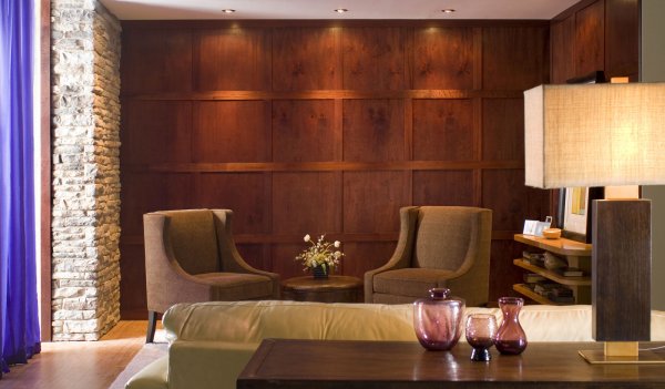

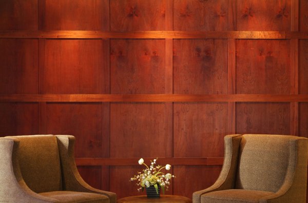

I think they should be covered with wood strips. The issue becomes how many, where, how thick, etc. I have always been partial to a paneled look in wooden rooms. This means strips that form squares or rectangles, repeating around the room. The flat panels in each center "float" slightly to deal with expansion and contraction. It's an old English library look found in clubs, country estates, and some municipal or religious buildings. I don't think it would go over with your aesthetic of clean modern lines, large proportions , glass, metal. I might consider breaking up the long horizontal lines with a few vertical lines, but that is a subjective thing. If you glue each panel and there are temperature changes, you might have issues with the vertical joints between each section. I don't really know. You should ask the designer. The glued joints, being stronger than the wood itself should be fine. I wonder about gluing each panel to the furring strips. Usually the trim strips covering the joints are designed to cover the potential movement of the flat panels.
Alternatively, you could design a "reveal" strip between panels, which is a purposeful gap so that there is no butt joint which may either open up or compress with temperature and moisture changes. These reveals create shadow and break up the flat surface too. They can look very good and modern if well done.
Acoustically, a broken up wall with many raised panels may sound better than a flat large surface wall with just those two horizontal bands at 9' and at the ceiling, but that is a question for Bonnie. If you are curious, just try to find a large wall somewhere made of wood. You will find that there are ways to deal with seams.
I think what you have will go very nicely with what seems like a modern So. CA aesthetic.
I was just in Germany, so the greatest modern German architect comes to mind. Ludwig Mies van der Rohe said "God is in the details." I just found this: http://thelistenersclub.com/2014/05/21/god-is-in-the-details/

Many options. Walnut always looks beautiful.....very nice!

This sounds completely absurd (precisely because it is completely absurd) but it has taken me two months to figure out a stain for the walnut which sinks into and “seals” the wood but does not apply any kind of shiny coating which could reflect sound and change slightly the natural acoustic character of the hardwood walnut. So this means using an “oil-based” stain.
I wanted to preserve the natural color of the walnut without darkening it or changing its color. I went to the lumber store which fabricated the pressure-glued walnut planks and asked for an oil-based stain which is clear and does not change the color or tone of the walnut. He gave me the “Pure” stain from a company called Rubio monocoat, which he assured me does not darken the wood.
I learned previously that the color grey is fiendishly complicated because it is very, very difficult to find a “true” grey. In different kinds of light different greys “read” as leaning to blue or to beige or to green.
It turns out that Rubio Monocoat Pure actually makes the walnut a lot darker and brings out the grain in the walnut — exactly what I was hoping to avoid! Many people love dark wood paneling, but to Tinka and me it looks too old-fashioned and too much like a hunting trophy room or a cigar and scotch man-cave. Traditional dark wood paneling is not what we personally want for our contemporary-looking house.
So this launched me into two months of testing about nine different colors of Rubio Monocoat stains. Along the way we decided to solve the problem of not liking natural dark wood paneling by focusing on fairly heavy stains that almost “paint” the wood grey while leaving some wood grain texture peeking through.
So I have finally ordered the color we selected and we hope to begin working on the listening room wall paneling soon. We selected a Rubio Monocoat color named “Gris Belge.” I have no idea where that name comes from, but it is a grey which leans toward beige, and this counteracts the tendency of most grey stains and paints to lean toward blue which we do not want.
Just to make this whole process more maddening I also learned that once the stains dry they can look materially different from how they looked when they were first applied. The photo above shows the stain on the left looking darker and more true grey than the stain on the right. But when they both dried the stain on the right looks darker and more grey than does the stain on the left!
