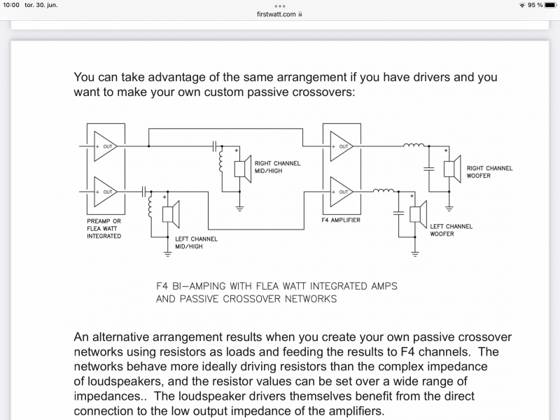

I am now in dialog with Werner regarding ordering one… I understand from him that it comes av a 3-way network 500hz and 8-10 kHz for a ultra HF unit!? Is 10 kHz the right point on my 288G? I have both a JBL 2404 and Fostex A500.
Another point is that his filters can be bi-wired/bi-amp(filter part for the 515 are separated from 288). Considering to use my First Watt F4s for the 817, letting the 300d SE drive both the 288+HF and also the F4s working the 817. Nelson promotes this idea in the F4 manual, Werner thinks it’s a bad idea but doable… anyone that has experimented with the F4s in this direction ?

View attachment 95141 Considering to use my First Watt F4s for the 817, letting the 300d SE drive both the 288+HF and also the F4s working the 817. Nelson promotes this idea in the F4 manual, Werner thinks it’s a bad idea but doable… anyone that has experimented with the F4s in this direction ?
I originally built my F4 for exactly this purpose... Coincident 300b Frankenstein monos driving the tweeter and midrange of my Coincident PREs, and also an F4 that then drove the speakers' separate bass modules.
The 300bs didn't really have enough power for this speaker (I upgraded from another more efficient Coincident design) and I was trying to lighten the load to save an amplifier that I really loved. In the end I lost a lot of coherency and didn't feel like I really gained anything substantial on the top end either. Then I tried running the F4s full range and was shocked to find that I actually preferred the F4s. Eventually I sold my beloved 300b monoblocks and put together full F4 monoblocks with top end parts and hugely overbuilt external power supplies.

I have had some more input from Werner Jagusch who at this moment are building new crossovers for my Altecs. I suggested for him to incorporate the F4s into the filter design combining them with a SE 300b. His reply/experience is that, yes you can do this but you gain little to nothing at the cost of coherency.

I am not sure why you insist on F4 without trying both. At least give the only 300b a try. Altecs do not require SS power to drive the woofers. Often this works against it, reducing bass by gripping too much. Werner is not expensive so you can try both. F4s will work differently with non-Altec woofers. I can't speak for F4 particularly but SS amps with grip have negative effects on Altec. So not sure how much grip F4 has.

Depends if the SS amp has negative feedback on the output stage (or global). If the damping factor is too high then low Qts woofers all lose too much bass (even horn loaded). Horn loaded low Qts woofers like little to no damping from the amp...as they are already quite well damped. If the F4 is feedback free then the output impedance may not be all that low and there is a chance for decent bass then.

Yes I don't know what the output impedance and damping factor of F4 is, and how it compares to the 300b that he has. But surely, best thing for him is to listen for himself with both crossovers as it is not expensive. Right now he seems set on this biamping theory of using 300b on midrange and SS to drive 15 inch woofers.
