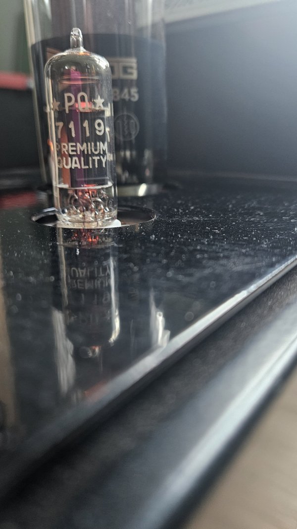

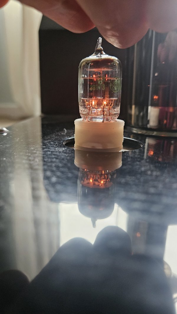

Been letting the amp play. As you get use to it, its very pleasant and easy to listen too. Take off the audiophile hat and it becomes a enjoyable amp. BUT. Stupid volume on the front pops sometimes. It has a stepped volume attenuator. I think the signal goes through it, then into the signal tube. Well, I changed the pre tube to a very nice Telefunken E88CC that cost about $350 per tube. Stupid amp may have popped a couple times it popped really loud, Now the tube is microphonic. I'm pissed. I;m wondering if there is any way to get into the attenuator and spray deox or something to stop it, I don't want to risk any other tubes.

But the nice Telefunken was likely already microphonic. There's no circuit defect that can cause a tube to become microphonic! I'd return that Telefunken if you can.

microphonics, simply tap the tube gently with a pen. If noises occur, replacing the tube is the only solution. The noises usually come from the tube grid, which has become mechanically loose in the tube.

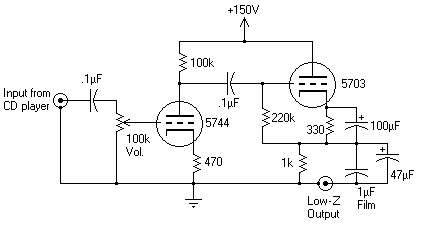

I really don't like that schematic! That 150V can't be right.

Film caps rarely get leaky unless they are ancient. I run into that sort of thing when I refurbish stuff from the 1950s or earlier. But that shouldn't be happening with any modern stuff. From all this it just sounds like this amp has been sitting around unused too long.
