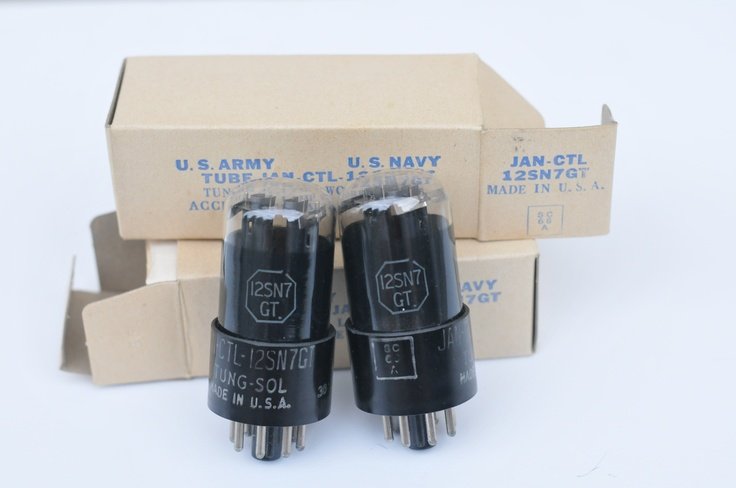

Black Tungsol Tubes are amazing JAN CTL 6sn7gt/(12sn7gt Heating 13 volt)
They are highly musical and they add enormous detail to the music.
What are the date codes on those? While the 6sn7 and 12sn7 are the same tube, I read that they need different voltage circuits, 6v vs. 12v. That true?
same tube specifications, different heating voltage.

I hear you, but we need to clarify: What are the date codes and does the different heating voltage affect whether or not one can use the 12 version for the 6? For example, I have a Supratek Chardonnay preamp.
The 12SN7 must be used in a circuit that provides 12v to the heater. I have a Lampizator Baltic DAC and ordered it with a switch that allows me to use either a 6SN7 or a 12SN7. I have a stash of 12SN7 TSRP tubes as well as some 14N7s and some Raytheon 2C50 tubes that all need 12v. Very few regular production amps/preamps support using a 12SN7 as the stock option.
The main benefit of using 12SN7 tubes is that they are much cheaper than the exact same model 6SN7. For example $100/pr vs $500/pr for Tungsol with black glass and round plates(TSRP). They will sound the same as the 6v version.
Most electronics techs could modify an amp/preamp to use either. You do need a 12V heater trafo, so if you have 6V trafo you need a different one, but they aren't too expensive. Then install a switch to change from parallel or series connection of two tube's heaters.
Just be careful not to use 6SN7 when the switch is in the 12SN7 position!
