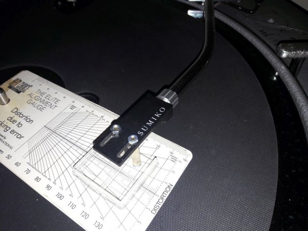

Once he has the ddk jig, his 3012R alignment challenges will be over.
Effective length, that is pivot to stylus distance, varies with different mounting hole to stylus dimensions. How does David’s jig allow you to avoid adjusting overhang for optimal alignment? Perhaps I don’t understand what the jig does.
The DB Systems protractor (purchased on DDK's recommendation) is the only commercial protractor I've found that works with the SME sliding base. It has two plates and you rotate them to align the headshell. It's very similar to the paper jig the SME arms come with, only it's more accurate. Most people just use the paper jig that the arm comes with.
Ian, you may still need to adjust overhang for proper alignment if the cartridge mounting hole to stylus distance varies with your three cartridges. Arm height and VTF may also need to be adjusted, so it may not be a simple swapping of head shells. Then there is cartridge loading to consider too.

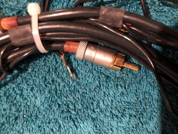

I'm still getting used to the 3012R's operational mechanics (the arm rest lock is a little strange and the arm feels so flimsy) as well as the sonics. I looked into my bag of tricks and found an SME phono cable (can't recall why I ever bought that but I did) and no longer have a cable issue per se. I feel like I'm hearing a little bit of a metallic signature that is probably the cable, but overall I'm digging the sound very much. I'm probably hearing my Atlas more accurately than with the Black Beauty (given the VTF issue I had) so some of what I'm noticing might be that. The sound is VERY clean and clear though; piccolos and other high frequency instruments are coming through nicely, bass is clean with good punch and transients are super. Piano is fantastic.
It's not a jig per se Peter, it's a headshell with a scale. You mount the cartridge in your headshell then measure the distance from the back of the headshell to the stylus tip with my headshell gauge then mount it on the arm like a heashell. There's a scale and you use your measurement, ie 49/50/51mm etc. for your alignment. The advantage is that you're not risking your cartridge, have an accurate scale with a large window and perfect outside lines of the frame to easily align the tonearm with the protractor; no more guesswork and or trying to figure things out with odd shaped cartridges. In the set there will be a similar gauge for fixed headshell tonearms too.
david
david
Sounds very promising...!
david
I should have registered the patent ... :)
My crude device was inspired in an article about tracking errors - the authors measured them for different geometries using a similar tool. Thanks to it I found I could mount the SME 3012R in the EMT 927 without extra tooling!
Records were the dominant media for over 50 years Francisco every gadget one can think of has been made at some point including my gauges. What you see today including the Smartractor and Feickert are reissues of older designs with small improvements. The gauge set I'm making is no different it's based on ones I used and seen before, just try to make them more complete. Also they're not made anymore otherwise I wouldn't bother with the manufacturing headache.
