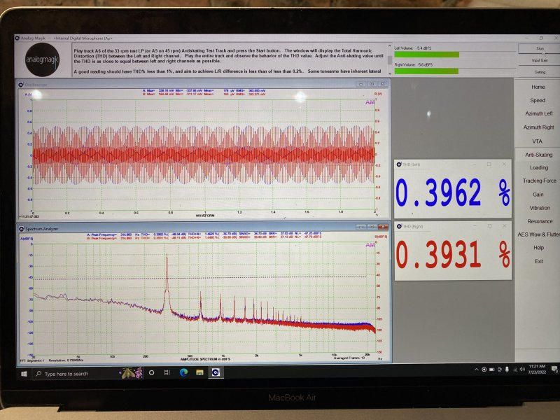

Attached is the image of the antiquating test result.

By the when I said distortion figures should not exceed %1 I meant at the end of anti-skating tracks. %0.2-0.3 is very impressive.
I am confused. As the outer tracks plays fine and just the inner tracks which are distorted. But what are the causes? bad turntable antiquating settings or just terrible stylus with low compliance ( particular challenging as the linear resolution is limited ? )
Yes. Thats the track 6 of the audiomagik test.

Check the distortion figures at the end of the anti-skating track. When the track finishes.
