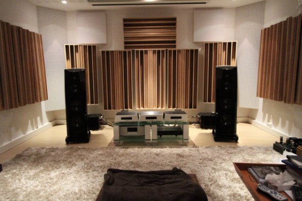

Hi all,
Attached you will find a picture of my current room, with my new speakers Rockport Avior and my Mono Totaldac ?
The room is (only) 22 m² and the acoustic treatment has been a kind of designed by myself after a (very) long time of trial and error and weathering some differences in view with my spouse;).
A period during which I found out that small room acoustics is a real niche within the science of acoustics and at the same time I found that not many acousticians understand the requirements of such dedicated room, actually hardly any of them… reason why I enrolled myself on a 6-month course about acoustics to improve the understanding of the theory behind the practice and start my job as an acoustic consultant.
During the adventure to seek the best design I came across a company on this site whose approach to acoustical problems in small rooms is definitely different from the pack. That company is SMT and I got in touch with its owner Matts Odemalm who has been very helpful in explaining his products and making sure I could hear them in my room.
To cut it short, I was enthralled by his S-wings and V-wings, so much so that, beside my activity as acoustic consultant, I will be holding some stock locally.
This cooperation led to a first result, rather quickly mounted, at the Hi End show in Brussels in October. Through the shop Noir&Blanc, Matts and I were enabled to treat their hi-end room (Rockport Atria / Gryphon Antileon EVO (worldpremiere in non-static display) / Esoteric Grandioso player and DAC) promptly making it the best room of the show (see attached link in French http://voir-et-emouvoir.blogspot.be/2014/10/une-ecoute-exceptionnelle-au-high-end.html?spref=fb) although the acoustic properties of the rooms, as usual at shows hosted in hotels, were far from ideal.
The S-wing is an ideal product to position at the first reflection points bringing more detail, focus and a wider soundstage and above all, a more homogenous frequency respons from the high treble till mid-bass (!!).
The V-wing is very similar in its functioning to the S-wing and is most ideally placed around anywhere basically, behind the listening position (can be up to 30 cms from listening seat), at other reflection points or in front of the front wall (as in previous post). Its time delay function (by about 5 ms) enhances the sense of the recording hall and makes the walls fade away.
Anyway, the next project is to change my room to a level 3 demo room for SMT which should be done by January.
I am aware that I shouln’t add much more to this as this will be read otherwise as a pure sales pitch but I guess the above is interesting to this WBF community that helped me on this path.

just received 2 more Wings panels.
The Effect is terrific , great!!!
Loudspeakers seem isolated from the ambient and the grade of details and refinement is truly incremented.
Is one of the best improvements of my system I have achieved.

They help my system to have more stable image, balancing the lack of the left wall.
Congratulation for your system and room , very nice, BTW, we share same source I understood (Totaldac).
Paolo
Thank you very much Paolo! I had the Totaldac for test, I have Weiss now. I really liked the Totaldac, maybe I Will get it.
Have you tried to put the wings a little closer to the speakers on the side? you can go so close as 30 cm. If you put the wings a little forward like on this picture you can get even more effect. These wings on the picture have the protektionfilm on.
Kind regards Krelle
