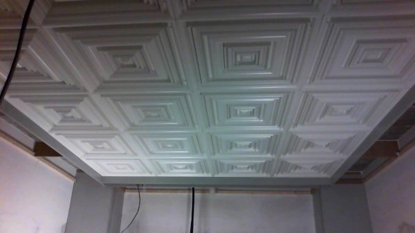

I am effectively building a reference room for myself at the moment with SMT material. It will be a level 3 room in 22 m².
I will be opening a separate thread when the room will be 'publishable'. An event, like an open door weekend, is being envisaged! Again, more to come in coming weeks.
Don"t know how to get the pictures straight but you get the flavour no doubt.
The casings you see against the wall are helmholtz resonators. I have a mix of them as being built, part of the ceiling and a number of V6, V5 and V4 varitunes.
The Flower, S- and V-wings still need to be brought in. I am waiting for all works to finish before these are moved into the room.

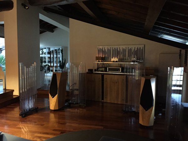

Thank you Krelle,
I will try to move the side panels. BTW I am in a different configuration compared the pictures you have attached, I am a little less than 4 meters away by the speakers.
this pictures in taken from my listening point.
Wings are continuosly improving.
Matts added a more stable basis (doubling the polycarbonate foil)
Paolo,
If you took the picture from your listening position, it seems the V-wing at the side is not positioned at the point of first reflection... :confused: It seems their effect could be increased by having the middle of the wing at the first reflection point which normally implies that the side of the wing, closest to the loudspeaker, is not more aft than the front of the loudspeaker. How much more to the front depends on the distance from the wing to the side of the speaker, listening position and preference...
Michel
Paolo,
Michel
Hi Michel, thank you,
yes, indeed, you are right, but I have to solve the lack of left corner, and this configuration seems to be the better. But I will try again, as you and Krelle suggested me.
I would suspect that by repositioning the wing as indicated the issue you describe will be further reduced, compared to how it is now. Again, needs testing all of that in situ.
I really like the look of your Diamond roof! Im looking forward to see more pictures in your new thread. Diamonds are forever.. Keep up the good work
yes, indeed, I have repositioned the wings as you suggested and the soundstage opened.
The middle bass is stronger and more physic.
Loudspeakers are completely disappeared.
The total image is superbly neutral, well-balanced, uncolored, natural and detailed at same time.
