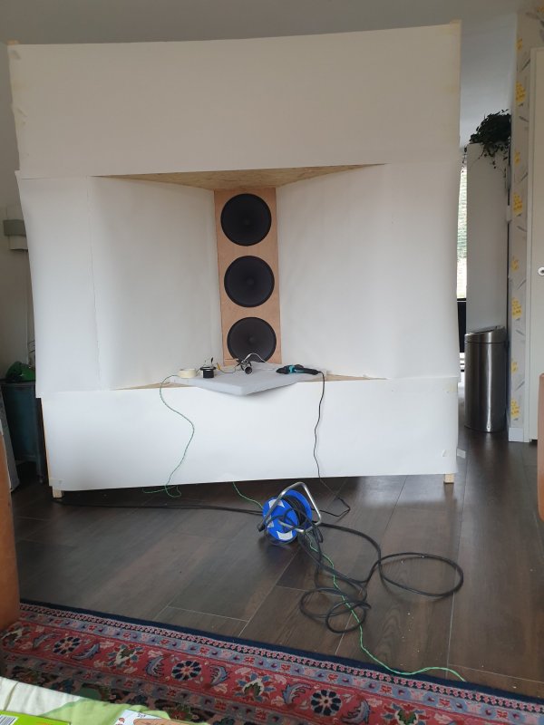

it's POC, so aquarelpaper on a wooden frame, picture below is from the final stage of putting the pieces together, currently the tweeter sits in front of the center of the middle full range unit. Last tweaks make me think the system is a keeper.

Looks pretty cool. What drivers did you use for this triple flh? What fc is the horn loading to? What drivers do you plan above this and what crossover?
the drivers are the Tesla ARO 835, a Czech sort-of copy of the KL405, the horn and baffle are a straight copy from the Bionor so 500-ish Hz.
No crossover on the fullranges and a 6db sine cap (hand wound coil, hand made loading resistor) on the tweeter at 7-8k.
Next step is to select the resistor material, gold, platinum, palladium, all with their own character and pros and cons.

aha, no now in parallel the resistance dips too low, they are 4 Ohm each...I had them paralleled for a while but running them in series now.
Most measurements of T/S parameters that I found should be taken with a grain of salt as they originate from enthusiasts rather than the company who made them (and that would not make them solid either IME), yet DC resistance is for real.
