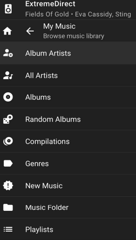

even after a re-scan, i'm not able to see (in TAS) all of my music.
for example, only 5 of the 9 Beethoven symphonies by Savall show up in the music folder
selection, yet i can see that all 9 are on the drive.
any suggestions?
i guess i could delete the current one and do a complete re-scan (versus an incremental one)............

TAS (LMS) scanning struggles with special characters in the Folder name. Removing or changing these special characters fixes the problem sometimes
XDMS has been deigned to disgest special chracters, and foreing language character sets

Not sure it helps in your case, but I noticed that if I browse into a certain folder from within the "Music Folder" menu of the TAS app, then I can see that same content also in the other context views (e.g. Albums, etc.). Not the most elegant solution, but it worked for me ...
By the way it would be a pity not to be able to access all the 9 symphonies from Savall, they are great and sound fantastic ;-)

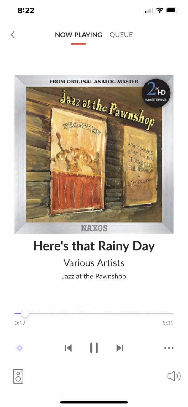

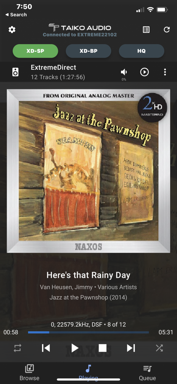

While playing DSF512 Jazz at the Pawnshop with TAS, very often the music would disappear while the track time counter is still counting. The music would return at the start of the next track and randomly might disappear again. The cycle goes on for the whole album. When switch to Roon, the album play normally. Any suggestions? Thanks
I have had the same problem and have mentioned it here before. I have found a fix in my system. When the blue bar is moving but there is no sound, I can easily correct the problem by pushing the stop button. Then I push the reverse button and then I push play again and it always corrects the problem at my end. I have found that this issue can occur regardless of which format is being played
