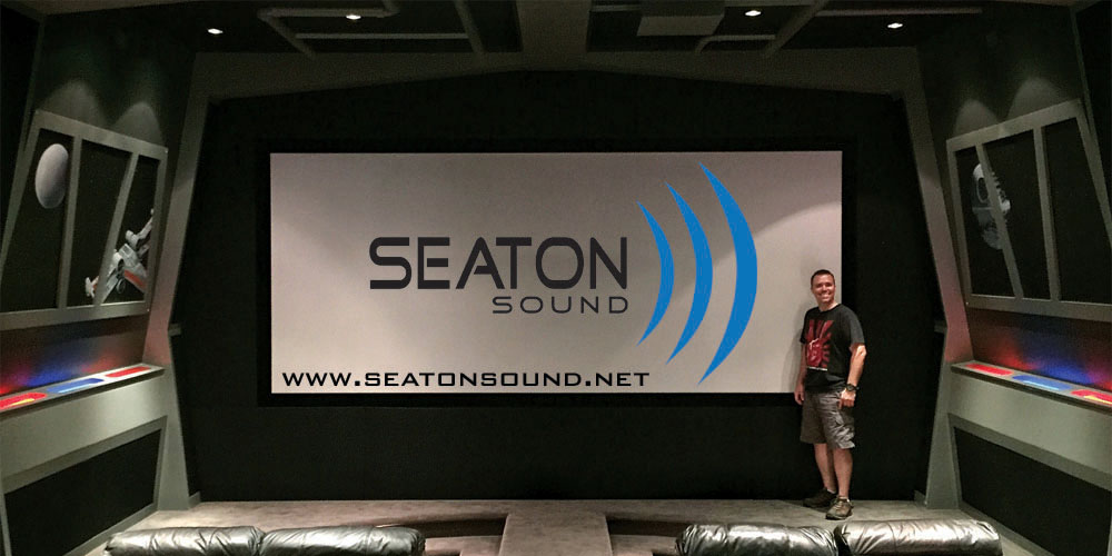

While the aesthetics of the room were quite impressive, the acoustics were an early attempt from the aesthetic designer, and left lots of midbass energy rolling through the room and too many hard surfaces. It was less offensive than would be in a small space due to the large dimensions, but higher playback volumes quickly became uncomfortable as the sound simply didn't die fast enough between the dynamics. I brought in construction and acoustics contractor Accurate Acoustics to handle the demo, construction, and acoustic material installation as I designed. With the room having an outer concrete shell, the entry doors not being acoustically sealed, and the couple and dogs being the only ones in the house, I abandoned concern for sound containment, and instead prioritized acoustics in the room. Here is what we started with:
Originally all of the black fabric accent panels on the side walls only had 1/2" foam with solid MDF behind them. We carved out each opening placing Roxul and a surface of Recore behind each piece of fabric which we updated to modern fabric track for a cleaner install and serviceability. With significant depth behind the openings, we hugely increased the absorption below 500Hz in the room, greatly improving the dialog clarity. To further control the sound in the room, we built out the front wall by 7" with 6" of Roxul and 1" of Recore in the areas around the screen where there were no speakers, and 3" of Roxul and 1" recore behind the screen in the area left around the subwoofers and center channel. To keep balance front and rear while also concealing the rear speakers, we built out a graphite fabric at the rear to conceal the angled rear speakers while similarly holding 6" thick Roxul surfaced by 1" Recore. The large entryway at the rear kept this from covering the entire rear wall making for an appropriate balance with the front of the room. The resulting acoustics were dramatically cleaner in the lower registers, with much more comfort while talking and improved dialog clarity, but the reflective ceiling and side wall areas still feels like a comfortable space and not an acoustic abyss.

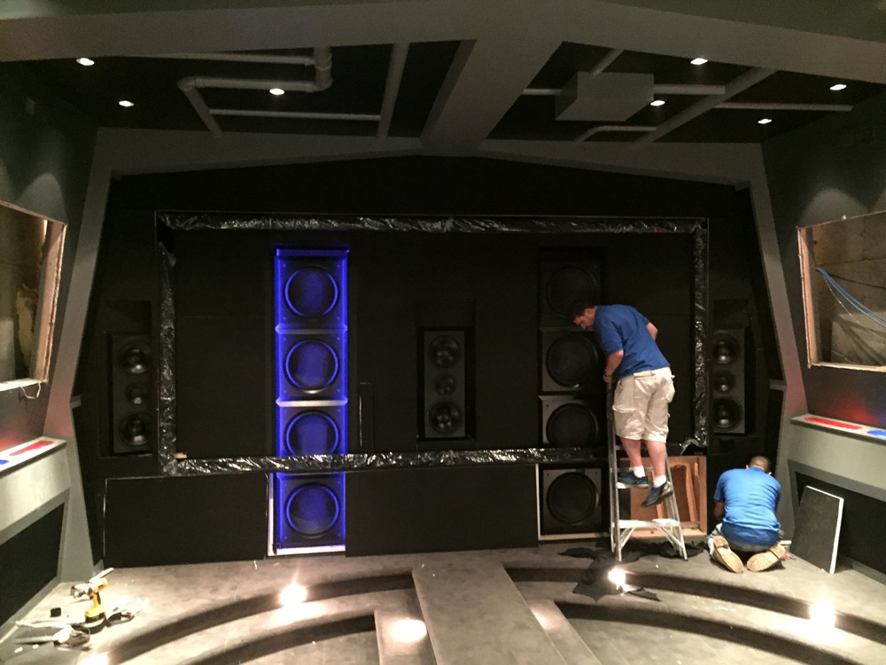

Of course the fabric track and walls make it much easier to fit any scale of speaker and subwoofer we want. Here is a look at the demo process of what was hidden behind the new screen and fabric:
