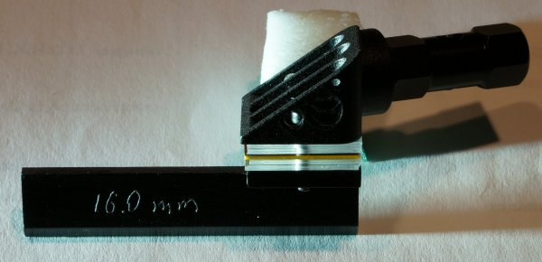

Here is a 4Point headshell with Wally VTA attached.
- You can see why a small bubble level can not work. There's no flat spot to put it.
Wally VTA
- Mount a cartridge, place it on a record, then measure the height to the underside of the headshell with a supplied scale. I do this once for each cartridge and write that down in my notes for it.
- The Wally VTA has shims of various thickness: .25mm, .50mm, etc. It's default height is 16.0mm. Add shims to equal the measure height of the cartridge.
- Rest the long blade of the W/VTA on the record and adjust arm height until the blade is perfectly flat on the record.
- Result: Tonearm/headshell bottom is perfectly level to the record.
From there I adjust arm height to assure equal amount of space, up and down, for adjusting VTA. There is a height gauge on the side of the 4P's VTA tower. I set the 'arm height to the middle marker on the gauge. I don't mind if you think this is less simple than eyeballing. :) I know a guy who uses a laser level to set the 'arm parallel.
Wally VTA
I guess I can visualize why the armboard height is relevant as it may apply to the 'arms height position as pertains to a starting point for SRA setting and possibly the amount of up-down space available for that. The 4P has a long shaft on its VTA tower that allows the 'arm to be moved up and down. If that shaft were short, armboard height could be critical. Thanks for the lesson!
Actually the Wally looks pretty straight forward, if the start point is accurate, ie perpendicular to record stylus, start by lowering the back for the vdH.
david
