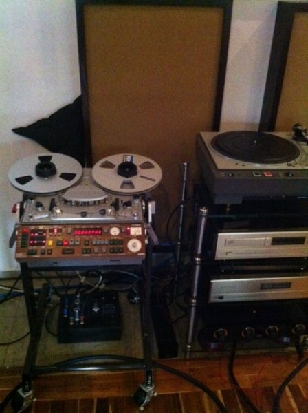

Nagra T back from the shop!
i) Modification to take signal out from the PLAYBACK head
ii) Interior cleansing
iii) Stand installation (Thanks again Ki!, I hope you have stopped kicking yourself for this :) )

Fernando-Your system reminds me a little of mine. Very nice Bro. It looks cool and a little untidy. I definitely have some clean-up work to do on my wires and cables.
I can make you feel better by posting a pic of my system, trust me.
I read somewhere..."the worst it looks, the better it sounds!"...(or something like it)
