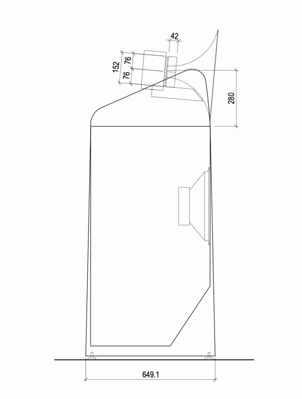

Looks great! How wide is the speaker?

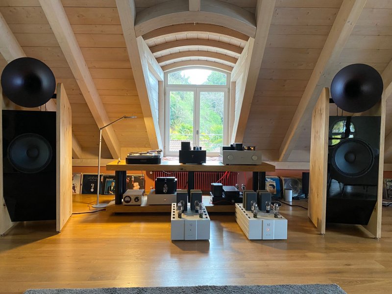

I got several videos from Gunter and I’ll post a few just for basic feeling. But i would advise to go and listen in person not only 18FH but as well smaller ones as they are really fantastic. His tube electronics i will not even mention as I’m in love with it.
BTW on the video: 18FH, MA200 power amps, SC12 preamp, Riverside audio TD124 with Origin Live Agile and Lyra Lambda cart goong via DHT phono pre.
