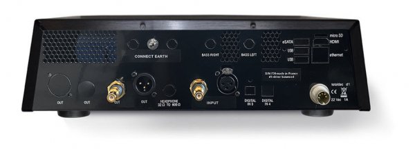

Here are updated photos of the d1-driver.
Rear view of the stereo version:
Rear view of the monobloc version:
For clarity.
If you have an unbalanced preamp or amplifier receiving the signal, two stereo units set up as mono blocks would be the same as the monoblock version.
Only when feeding into a balanced circuit would monoblock be required for a true balanced signal.
