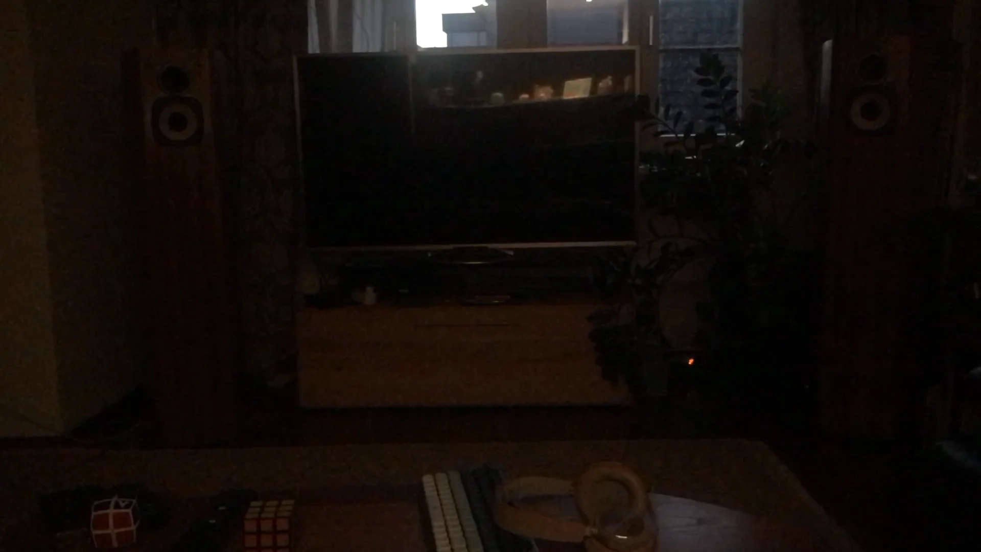

same system...in the dark! Digital not vinyl this time.
