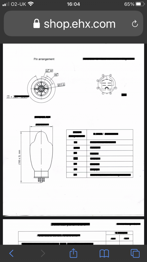

For some reason, when the link is shown there are thick lines put through the sentences, this must be an apple issue , maybe to do with codecs? Iam using a Iphone!

Document pdf attached - reads fine on a Macbook.
