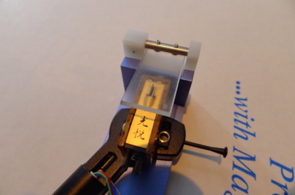

This is an example on a standard Phantom II arm with a blue jig
That is the correct wand head shell shape for the Supreme. Come to think of it, I was an early adopter of the Supreme and it came with the football wand...which is not offset ideally for the mounting slots (cartridge twist). I did not have Koetsu at the time. No issues for Koetsu on the proper Supreme head shell that is offset like the photo above. I suspect it's possible the Koetsu is too long for the football.

What color is your jig ? Is it blue or red ?
It is blue, but this seems kinda irrelevant since we also had the Mint protractor specifically made for my table/arm combo. The problem with the Graham jig, in my & my setup guy's opinion, is that it has a bit of movement and side-to-side give. For something that needs to be very precise, that's not great.
Just so you know, if your wand is XL 10", the Blue jig is meant for the 9" wand. Even when I got my first Supreme (early adopter), I noticed that (given the blue one) and was ordered a red 10" jig. The Blue jig will not align a 10 inch arm correctly. Yes there is some movement, but you can still get it very close on zenith angle.
