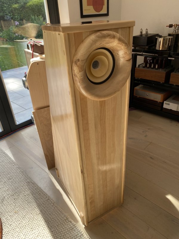

So the build has been progressing. Fitted feet and lower side trim together with various internal bracing pieces. Finishing the whole thing in blond dewaxed shellac with a French polish. This process is slow and laborious but it is more or less universally accepted from luthiers that shellac provides the best tone out of all the finishes. For me it was this or oil / wax. Definitely no polyester, lacquer or acrylic allowed on this one lol.
Fortunately the carcass has a removable back plate so I can test a few tweaks to back loaded horn geometry and length. I simulated a new model this week that on paper is even flatter with more extension so will try that out too.
Here is morning sun shining in on the first few coats of shellac. From here it will be levelled and repeated over many coats using French polishing. For the eagle eyes, you can see some through tenons on the side there. They didn’t need to be “through” but I quite like the detailing myself.
What is your gap to the floor now?
something like 8cm right now. I am waiting for some better spikes that I ordered that give a lot more.

Wait a second, I see sunshine and green grass. Surely this photo wasn't taken in the UK. Whose speakers are these ... really?!
Very beautiful all around, Bill.
+1 looking great inside and out Bill. They’re looking real purposeful. Love the detailing on them as well, just noticed the way you’ve braced the feet, it all looks so nice! Great stuff.
Haha - yes for once we got sun here. Thank you for kind comments!
