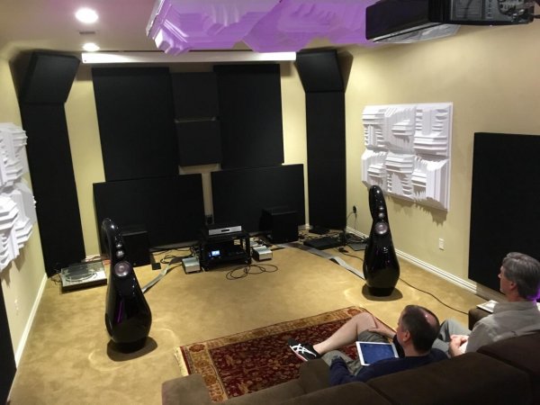

Wow those speakers are way out in the room and almost near field. I'm just curious if that was by choice or the best positioning you found via measurements?
Speaker/seated positions were based on forum comments. I previously took a poll on WBF and then averaged the results of various positions. I then plopped them down in that position. You must have missed it. Sorry.
