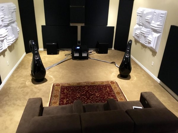

Now, this is what I am talking about....look at this set up and then compare to Michael's. I know which I would rather hear...and by a country mile!!!
You mean where they are sitting right now? I think he is just storing them there.
I'm talking about the room set up in general. The Kiis are placed right up against the wall.
That is supposed to be their claim to fame. And at any rate, he doesn't have the option of pulling the loudspeakers further out given the small dimensions of his room.

I removed my last two prim acoustics corner traps and hung corner modified 7" thick RPG bad panels. You can see the new traps in the rear corners above the purple lights.

Vivid speakers like toe in for sure. I have the tweeters pointed directly at the seated position. I've never been able to toe a speaker in this much without collapsing the soundstage. I previously had them about 1/2" toe in measured from sidewall. That's as much as I could toe in the YG Anat III without losing the big soundstage. I have the G3 at 3.5" toe in now. That's a lot more toe in. All other dimensions are the same.
The soundstage is just as wide as before. The midbass measures a little smoother and the HF is better integrated. Everything sounds much more resolving and sweet.

Wow Michael. You sure have a lot of surface material there. Do you have RT60 measurements of the room? I expect it to be on the low side.
Thanks. RT60 of 0.25 is very much on the low side. It is what I expect to see in multi-channel home theater setups. It is a pretty dry setup. But if you like it, you like it :).
Amir,
RT60 won't tell you very much in small rooms in absolute terms. It is a good point of reference when moving treatments in and out of the room. The midrange is a little over 300ms, which is about where I want it. IME, a room which primarily uses diffusion to reduce mid/hi decay versus a room which only uses bare fiberglass (home theater rooms) to achieve the exact same RT60 will sound VERY different. I've done it both ways.
Also, music preferences factor into the equation too. I listen to a fair amount of rock, pop, punk, dance and even some metal. Those genres don't sound great in a room with long decay, IME. I think all kinds of music sound great. :D

Amir,
If by "small" you mean RT60 is not valid, that is folklore that is created on the web. It is not correct. See this rather long series of posts/articles I have written on the topic: http://www.whatsbestforum.com/showt...nt-thereof-to-quot-small-acoustic-spaces-quot
That said, yes, in large performance spaces RT60 holds more value than in our listening room. Our use here is limited to quick assessment of whether a room is too live or too dead. Acceptable ranges are between 0.2 and 0.6 when measured @500 Hz. For music I like to see 0.5 to 0.6 and in the case of classical music and large performances, even slightly higher. For multichannel when the other speakers provide the ambiance, then lower values can be tolerated.
Also, one can visually determine RT60 as I did by looking at your room. In this case with fully carpeted room you are already quite a bit there with respect to total space that can be covered. Another way is by simply talking as human speech resembles the directivity of most loudspeakers at those frequencies.
As I said, as long as you are happy, that is fine. Just wanted to note it as chasing low frequency absorption often results in rooms that are overly dead.
