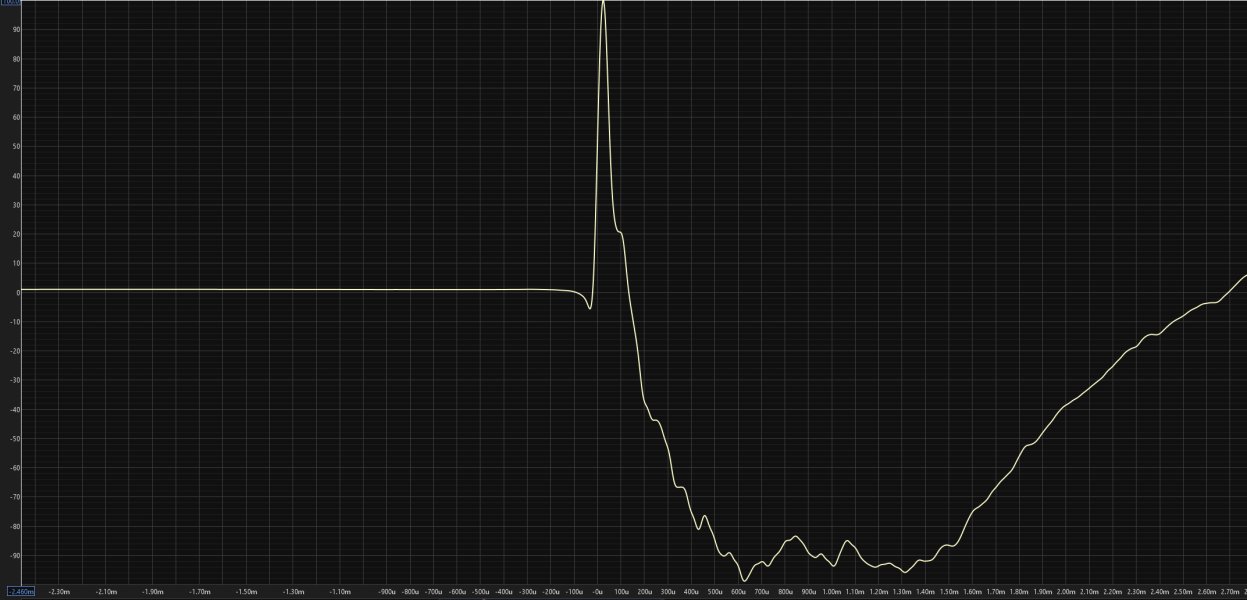

The latest version of the La Scala is smoother than previous versions. As measured by Stereophile (red trace, below) the high end could be interpreted as either being too hot or the low treble could be heard as recessed, depending on your perception and the particular music. The low end is erratic.
In the time domain, the La Scala is something of a mess, as is the Klipschorn. This will degrade imaging from as good as it otherwise could be if the drivers were time coherent.
As a point of reference, this is the step response of an Altec A-7 - it is basically a single coherent impulse, which is possible from it's natively time coherent design with the drivers vertically aligned (the HF horn can be moved independently to optimize this).
I’m sure tons of resonance ripples in the Imp Z/phase to match that horrendous step response ..!
Putting it mildly. o_O
That said, the Altec A-7 low frequency horn cabinet isn't anything to write home about in it's native state! I've installed a lot of extra bracing and filled some spaces such as behind the LF horn with a mixture of sand and plaster to render it inert. I intend to do some more impedance plots at some point soon.
