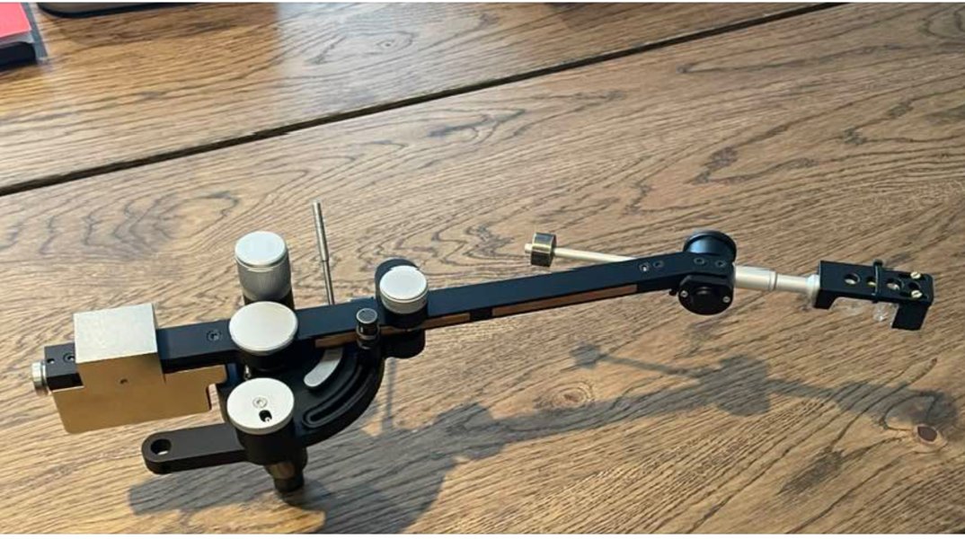

While I'm adding an AF 10 arm to replace my B-44 Elite and keeping my OG SAT in my main system (AF ONE), I've been intrigued by the current Ikeda high mass arms as well as their latest generation cartridge. I think it would be fun to mount one on an AF3 P. The traditional headshell mount would allow me to easily swap in my currently underused carts like old stone bodies, my SPU, even some MM carts.
I'm saving my EMT Banana for a future EMT project. The table is TBD and my JP-66 just needs it's volume potentiometer cleaned.
Why would you not add the EMT arm with maybe one of the top EMT cartridges to an AF3 TT? I use the Elite arm now but are considering the longer 12” EMT plus matching cartridges. Or even the Thales arm. However, I do think the EMT arm is a lot ‘of arm for the money.
I definitely could. I do have a question and I hope you can help me. My Banana came with bare wire, any recommendations as to how to extend and terminate would be greatly appreciated :)
I asked the company and will get back to you if I have their answer. I would thick connecting to XLR’s would be the best option.
Thanks!
