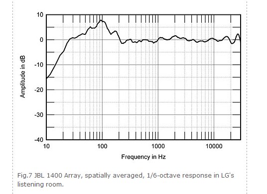

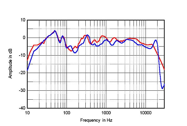

Well here are two in-room averaged graphs. I own a pair of the JBL 1400 Arrays. From an engineering standpoint which do you think will be more neutral to the source?? The Arrays are flat inroom because they were designed that way just as the Wilsons are not. The Arrays are also pretty flat on axis asside from the the "hot" tweeter.
The way to avoid flat failing apart is to have the speakers be a constant/controlled directivity design
Rob:)
