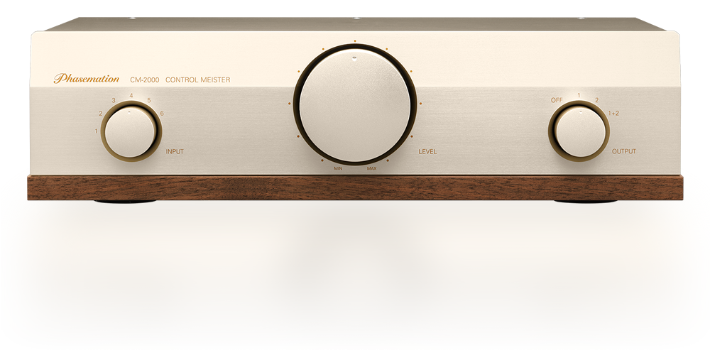

I am currently listening to music using the transformer based
Phasemation CM-2000
passive line stage. Compared to other PreAmps I had in my gear, the CM-2000 is one of the best.
Pairing to signal source, cable length and Amp needs to be done more carefully, than with the most active preAmps,
but if it fits, you are very close to the original sound of the source.
