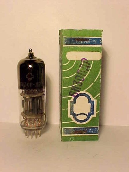

hello to all.. I am an owner of Trulife Audio's TLA 'ATHENA' as my main preamplifier that uses 6H30 tubes.. having deal many years with it I have bought and roll many pairs of 6H30's.. perhaps that tube is the most often rebranded and faked.. so after all those years of living and audition those tubes I have examined them very carefully and found the way to distinguish the fakes 6H30's (that is rebranded new production EH or Sovteks) from the original old Russians 6H30 DR.. here is my article, every friend of this forum can have a look..

I'd seen your article before and found it quite well done. Thanks!

There may still be some NOS 6H30 DR available somewhere, but I do not know of a reliable seller. As far as I know they are mostly gone a few years back. There may be private sellers who have stock put away but I do not have any knowledge there.
The last batch of 1500 6H30-DR was brought over by Evgueny of Conus Audio in Canada. That was around 2005. He sold ~700 6H30DR to thetubestore.com. They sold their last ones for $300 each. Conus had access to many great Russian tubes including the SV 6550C (St. Petersburg origin). I don't think they are still in business, but not certain.
The Sovtek 6H30 EB (or EV) works fine.
I suggest contacting Viktor Khomenko at BAT. info@balanced.com
Be very wary of 6H30-DR counterfeits.
