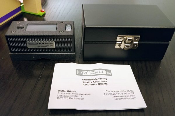

Pay all you want for the audiophile approved bubble levels. Even if I wasn't cross-eyed, there's parallax errors trying to read them.
I bought an AccuMASTER digital level for $36 from Amazon that's accurate to less than .2 of a degree. I took the batteries out and put them in another case and it's light enough to rest on the headshell while sitting on the tonearm rest. I use it with Adjust+ too. You can calibrate it on a known flat surface and it's very accurate.
