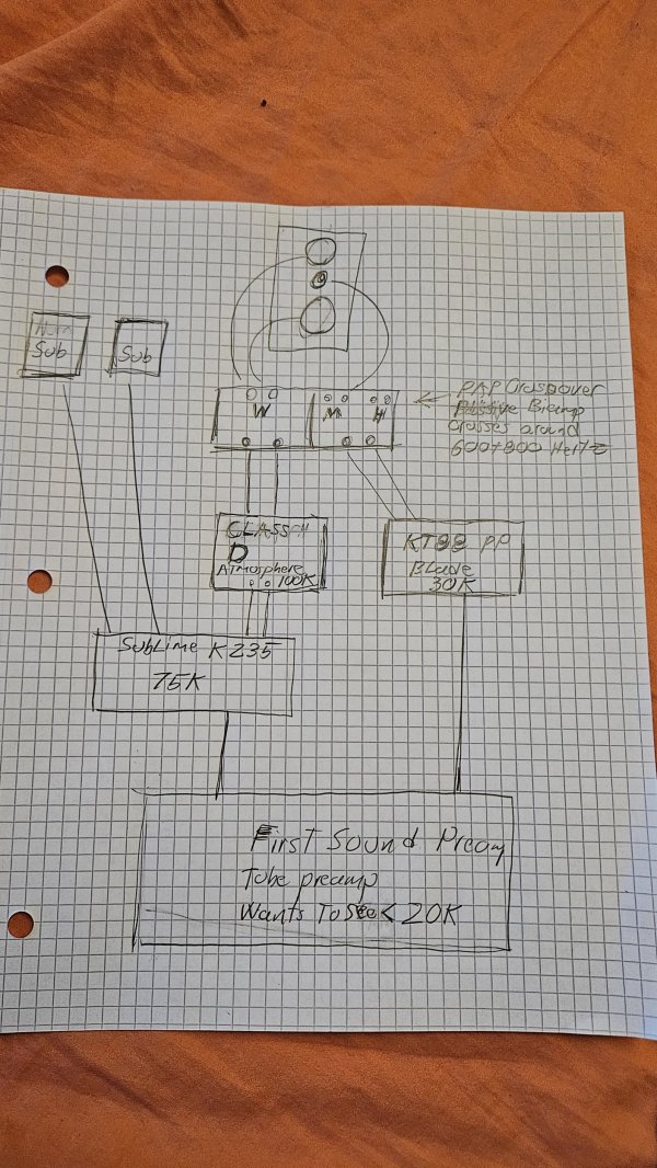

Here is another idea. This is if I add subs. And possibly biamp.
Again. My speaker is a PAP Trio 15 with Coax. The stock passive crossover is biaampable.
My First Sound tube preamp wants to see greater than 20K.
My Blade KT88 PP amp is about 30K
The Sublime K235 is 75K
In this, there is not much to do accept hook it up and add the right cards to the Sublime active crossover.
I maybe want to limit the signal to the Class D Atmasphere powering the main speakers to 80 or 100 hertz through the Sublime active.
The card going to the subs would maybe limit at 20 to limit any rumble or subsonic noise.
I also have to consider I may have to limit the gain on the KT88. If that were the case, baring going through the Sublime to limit the gain, where would I add a resistor to limit the gain.
Am I on the right track?
I don't want to repeat my self, but please consider my old post. https://www.whatsbestforum.com/threads/active-vs-passive-speaker-set-ups.19082/post-355542
BTW, Jim Smith in his great book goes frontally against by-amping using SS on bass and SET on top.
All just IMO - others can disagree - just posting because I spend a lot of time in such approaches unsuccessfully in the past, I still have an Audio Research EC22 active crossover somewhere . A good local friend wanted to get it, I decided not to sell it to him, he would surely come asking for help sometime in the future ... ;)
